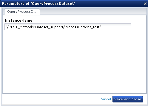

To return all of the parameters that a dataset contains, use the QueryDatasetParameters operation.
Follow these steps:
  1. Create a process.
  2. Drag the Execute operator to the Designer.
  3. Double-click the Execute operator to open the Properties palette.
  4. Enter the required parameters.

    Execute
    CatalystBrokerURL: https://hostname:7443/ucf/BrokerService
    MdrProduct: "CA:00074 (CA Process Automation)"
    MdrProdInstance: "CA:00074:01"
    Operation Category: "CA Process Automation"
    Operation: QueryProcessDataset

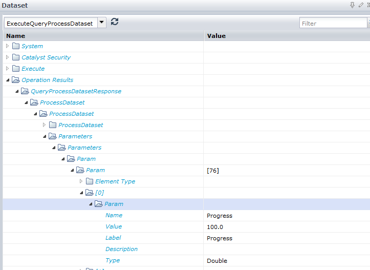

  5. Run the process.
  6. Review the output.
