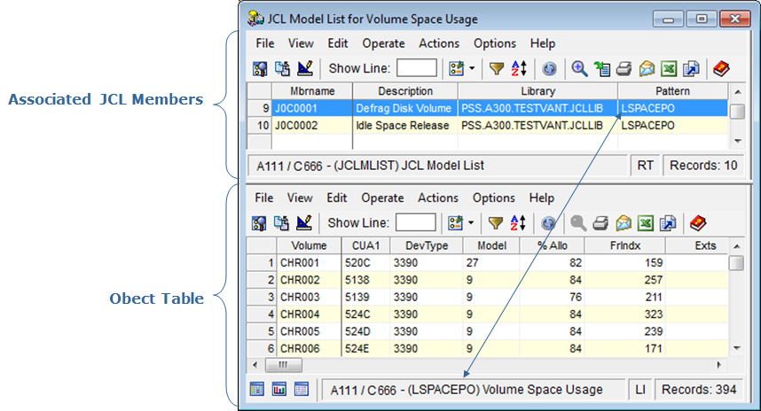

    The JCL Model List dialog appears. The JCL Model List dialog displays the object data and the list of JCL members associated with that object in separate panes as shown in the following sample:
    The following is a screen shot of the JCL Model List dialog
    The Object Table pane displays the object selected. You can use the object view menu options in the pane to change the object view, such as sort, filter, zoom, and so on.
    The Associated JCL Members pane displays the JCL models you have created and linked to the object selected. You can use the Associated JCL Members Action options to modify the JCL Model information displayed in the pane, add new JCL models, and to delete JCL Models.

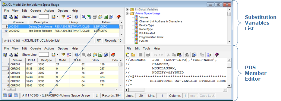

  4. Double‑click a model line, and two additional panes appear in the JCL Model List dialog; the Substitution Variable List for the object, and the PDS Member Editor with the model JCL.
    The following sample shows how the JCL Model List displays all 4 panes in the JCL Model List dialog.
    This is a screen shot of the Windows Client JCL Model List with all four dialogs in one window.
    Using the PDS Member Editor pane you can edit the model JCL, create new JCL Models, insert variables, substitute variables with object information, submit the JCL, and so on.
    Note: For more information about PDS Member Editor options click the Help option on the PDS Member Editor pane Menu Bar.
  5. Click your cursor in the JCL in the PDS Member Editor pane where you want a variable to be inserted, and then double click the desired variable in the Substitution Variable List pane.
    The variable appears in the PDS Member Editor pane where you indicated.
  6. Repeat step 5 until you have included all your variables in the PDS Member Editor pane.
    Now you are ready to substitute the variables in your JCL with object line information.
  7. Click a line or multiple lines in the Object Table pane, then drag-and-drop them into the PDS Member Editor.
    When you do this, a new PDS Member Editor dialog is opened with the resulting JCL; that is, the field values from your selected object table lines are substituted into the variable locations in a copy of your JCL model in a new PDS Member Editor dialog.
