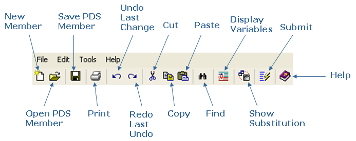

The following is a sample of the Windows Client New PDS Member Editor dialog that is displayed when you select the Member Editor (Submit) function under the z/OS menu option.
The PDS Member Editor dialog provides the following toolbar options:
Note: For more information about PDS Member Editor options, click the Help icon on the PDS Member Editor dialog Toolbar.
