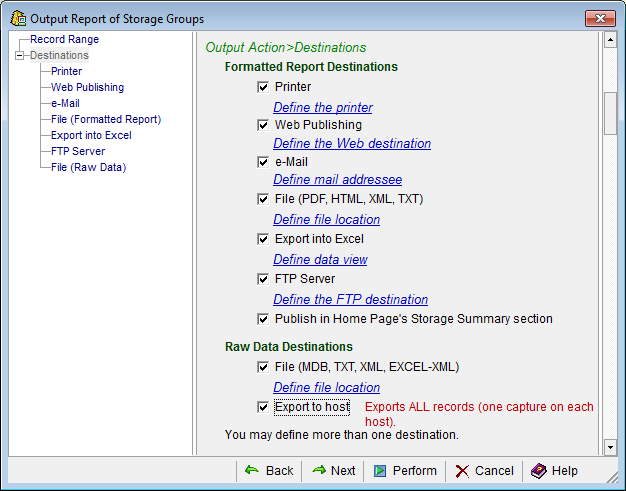

The following is a sample of the Windows Client Destinations page of the Output Report wizard for the Storage Group object.
This is a screen shot example of the Windows Client Output Reports wizard Destinations page.
Each output destination gives you additional options as shown in the following example procedure for creating a Formatted File.

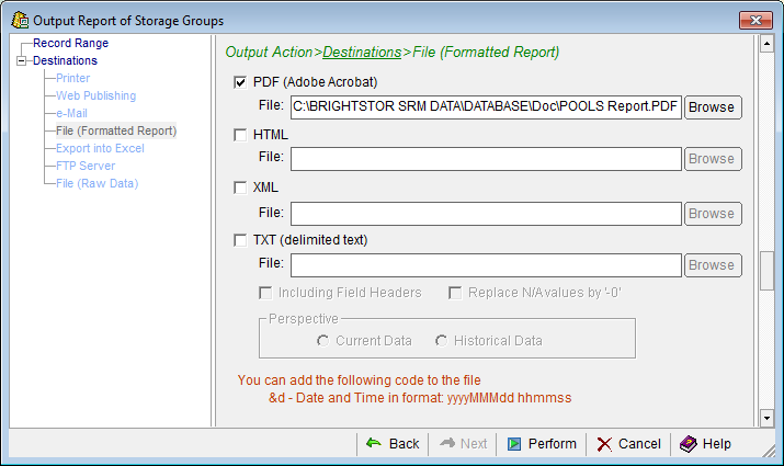

  2. Click the Define file location link.
    The File (Formatted Report Destinations) Destinations page opens with PDF (Adobe Acrobat) format selected, as shown in the following sample:
    This is a screen shot example of the Windows Client Output Report wizard Destinations File Formatted Report page.
  3. Click the box next to the formats of the report you want to create. For example, select the box next to HTML option if you do not want to create a HTML file.
    The File: field is populated with a default location dependent on the formats selected.
  4. Click the Browse button next to the File: field if you want to change where the report is to be filed.
    The File: field is populated with the new file location.
  5. Click Perform.
    The File (Formatted Report Destinations) page closes, and the file is created and filed in the location indicated.
