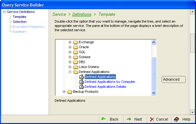

- Click the Configuration menu and then New in the Query table. The Query Service Wizard opens. From the Query table main menu, select Configuration, New. The Template dialog opens. Expand Applications, Defined Applications, and then select Defined Applications:

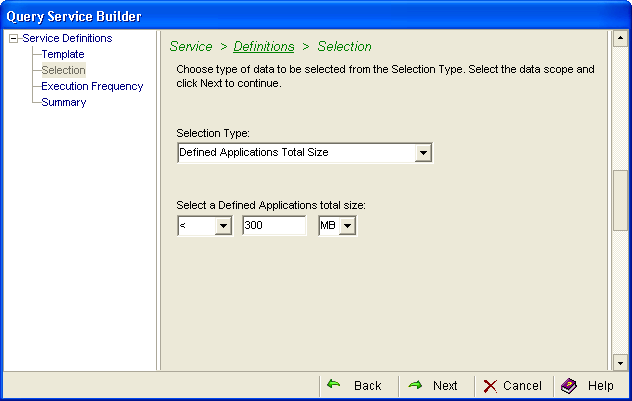

- Define the scope of your query by selecting Defined Application Total Size from the drop-down list. Enter a total size. In this example the application needs to be less than 300 MB:

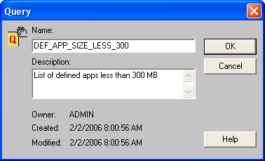

- Enter a name for the service in the dialog. You can also provide an optional description. When you finish, click OK. The service executes or saves depending on what you selected in the previous dialog:
