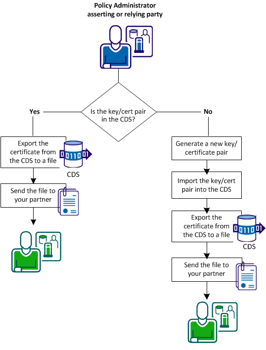

The procedure for sending the required certificate file to a partner depends on whether the key/certificate pair is already in the CDS.
The following figure shows the steps for sharing certificate files.
Flow diagram for sending a certificate file to a partner
Follow these steps:
  1. Generate a new key/certificate pair.
  2. Import the key/certificate pair into the CDS.
  3. Export the certificate from the CDS to a file.
  4. Send the certificate file to your partner.
