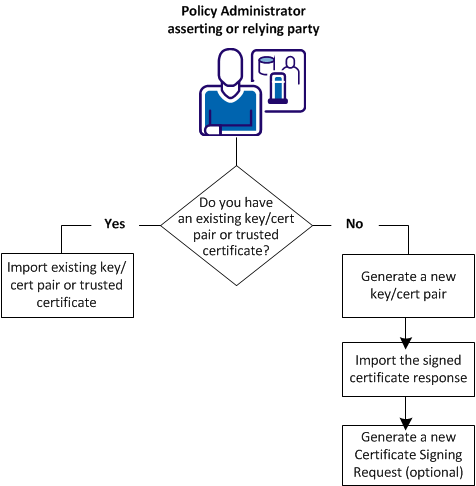

The following figure shows the steps for each method of obtaining a key/certificate pair or trusted certificate.
Flow diagram for importing or generating key or cert pairs
