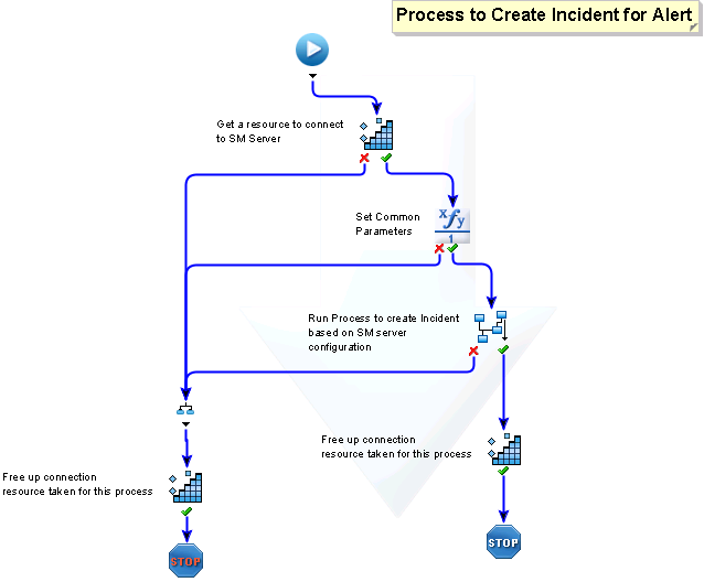

- Double-click the CreateTicket process.
- (CA Process Automation r3.1 Only) Click Edit User Preferences at the bottom-left of the screen. The User Preferences dialog opens.
- (CA Process Automation r3.1, r4.1 Only) Select all options except for "Default to horizontal line orientation" on the Configuration tab, select the Palette Properties tab and enter 12, and click OK.
- Verify that the process looks like the following graphic. The graphic shown is for CA Process Automation r3.1. The process flow for CA Process Automation r4.0/4.1 looks similar, but with different icons.
