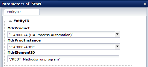

Start a process
Use the MdrElementID of an ITActivityTemplate.
Catalyst CA Process Automation connector parameters for starting a process

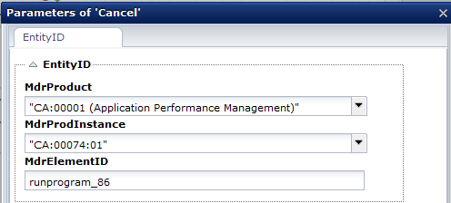

Cancel (abort) a process
Use the MdrElementID of an ITActivity.
Catalyst CA Process Automation connector parameters for canceling a process

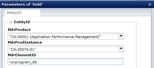

Hold (suspend) a process
Catalyst CA Process Automation connector parameters for holding (suspending) a process
