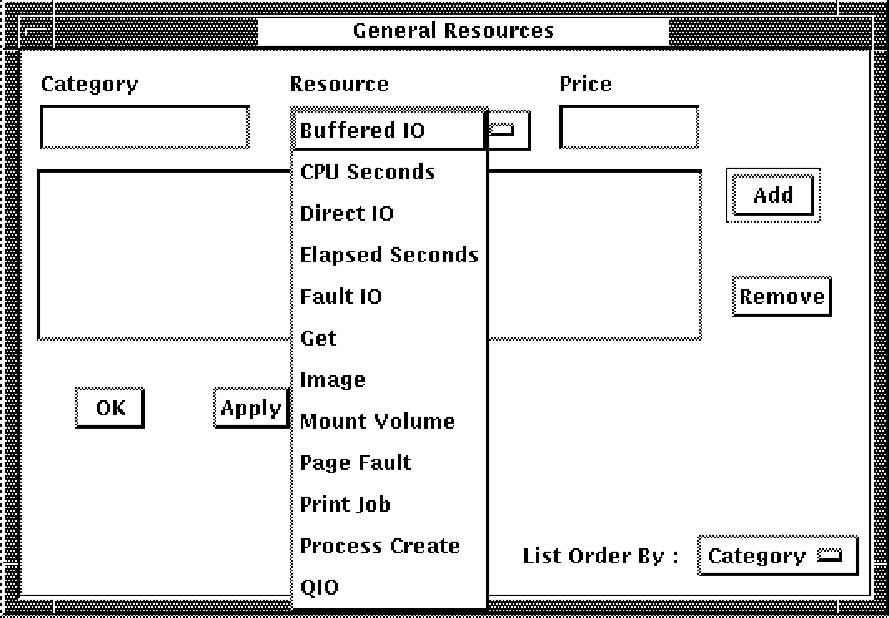

- Pull down the Select menu and release on the General Resources . . . menu item.
The screen displays the window shown below.
- Select Get from the Resource option menu.
For each price you want to enter
- Point to the Resource box and hold down the left mouse button. Release on the system resource you want.
- Click on the line below Price and type the price.
- Click on the line below Category. Then type the category you want. If you do not want to specify a category for the resource, leave this line blank.

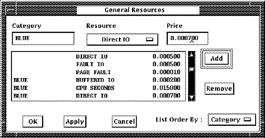

You can display the entries by category or by resource. Point to the List Order By: box and press and release on the choice you want.
- To include your entry, click on Add.
If you want to add an entry similar to an existing entry, you can copy the entry to the entry line. To copy, double click on the entry. The entry will appear on the entry line, where you can edit the entry to create a new entry.
To save the completed price list into a file, click on Apply.
The following figure shows some example prices and categories that have been entered.
