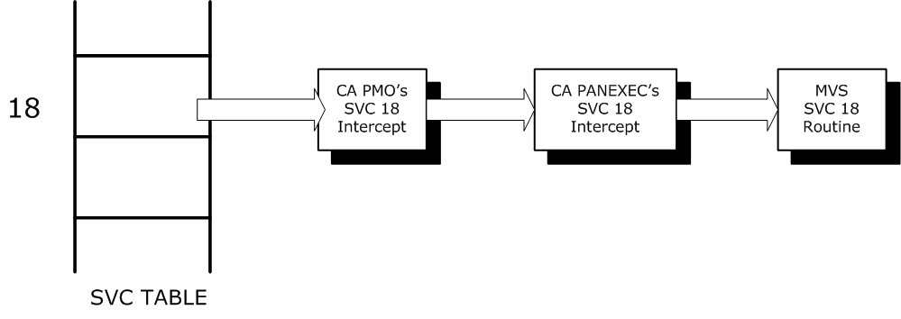

- Specify PANEXEC=YES in your parameter data set. This is necessary since the CA PMO SVC 18 intercept must execute before the CA Panexec SVC 18 intercept. When the value of PANEXEC is YES and you start CA Panexec after CA PMO, CA PMO stops and restarts itself to ensure that its SVC 18 intercept executes first.
Note: CA PMO does not reuse the ECSA that it needs when it is restarted. If ECSA usage at your site is critical, be sure to start CA Panexec before CA PMO so that CA PMO does not have to stop and restart itself. The following illustration shows the correct order of the CA PMO and CA Panexec SVC 18 intercepts:
