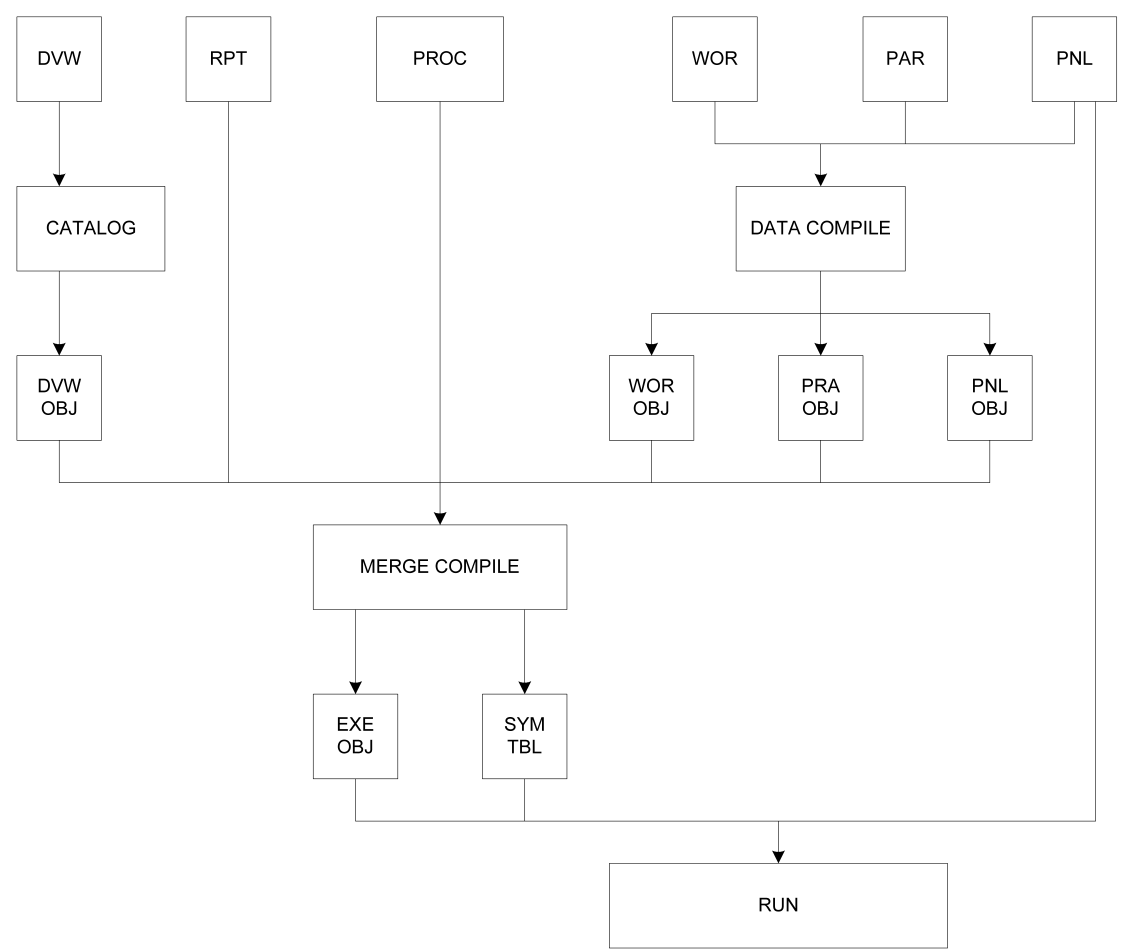

During compilation, CA Ideal creates a variety of blocks. None of these blocks can exceed 32KB. The FAT and Symbol Tables can span multiple blocks. A single data entity occurrence, which means a 01 level data item, dataview, or panel, cannot exceed the 32KB limit. This means that no 01 level can have more than 1,600 fields or it exceeds the FAT table limit. A 01 level can have between 800 and 1,600 fields (depending on the size of the symbols) or it exceeds the Symbol Table limit.
The following graphic shows the compilation process in CA Ideal application:
