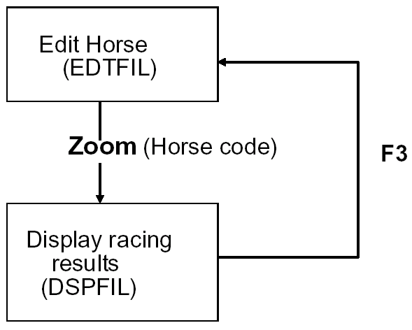

To link two functions together to build a larger function you must define the second function and an access path on which it is based.
For example, you could modify the Edit Horse function so the user can zoom against the detail line for a particular horse on the Edit Horse panel to view a subsidiary display of the races in which the horse has raced.
The following illustration shows two functions linked together:
To achieve this, you need to define a new function that you might name Display Racing results.CA 2E lets you define the new function while you are in the process of modifying the action diagram of the existing function.
