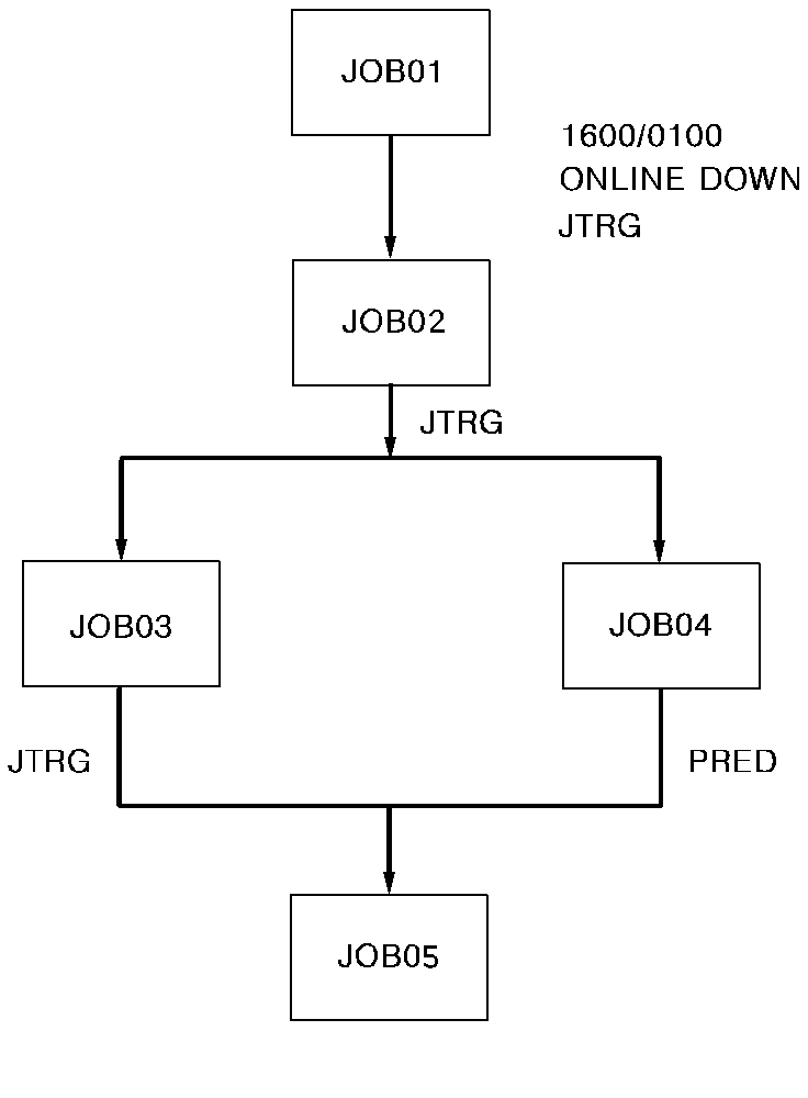

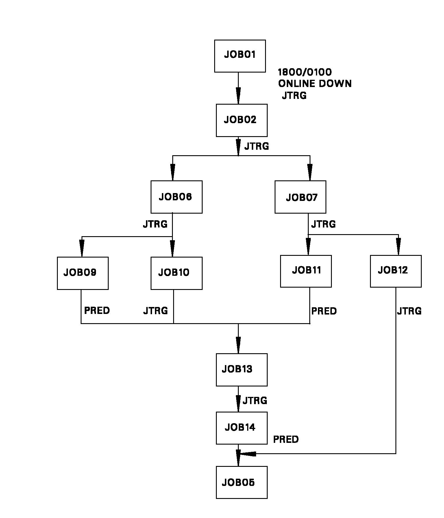

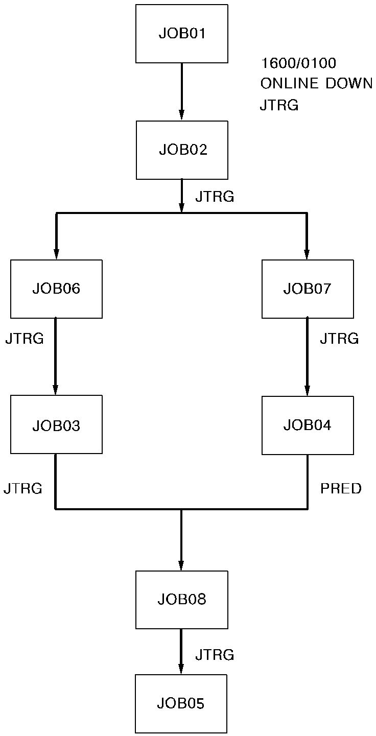

This topic contains examples of the kind of flowcharts you can use to organize your jobs into groups. They illustrate an accounts payable system with three different scheduling variations:
SCHID=1
The first flowchart shows the daily processing flow. This flow runs Monday through Friday, except the first and last days of the month.
SCHID=2
The second flowchart shows the first day of the month. This flow processes the normal daily jobs, and several monthly jobs.
SCHID=3
The third flowchart shows the last day of the month. This flow processes some of the normal daily jobs and some different monthly jobs.

The following is a sample flowchart for SCHID=1.
ca7ola01-new
The following is a sample flowchart for SCHID=2.
ca7ol400
The following is a sample flowchart for SCHID=3.
ca7ol300
The following is an alternate flowchart for SCHID=1, daily flow.
Jobname                   DOTM/LDTM               Requirements
JOB01                     1600/0100               Online down
  JOB02
    JOB03
      JOB05                                       JOB04
    JOB04
The following is an alternate flowchart for SCHID=2, first day of month.
  JOB02
    JOB06
      JOB03
        JOB08                                         JOB04
          JOB05
    JOB07
          JOB04
The following is an alternate flowchart for SCHID=3, last day of month.
JOB01                           1800/0100               Online down
  JOB02
    JOB06
      JOB09
      JOB10
        JOB13                                           JOB09, JOB11
          JOB14
    JOB07
      JOB11
      JOB12
            JOB05                                       JOB14
