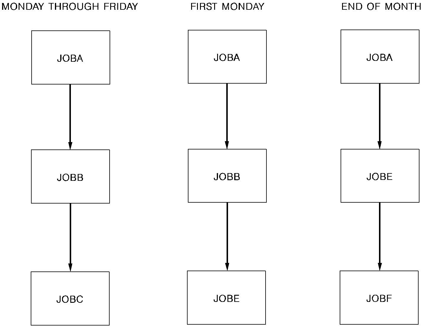

Schedule IDs are 1- to 3-digit numbers that are used to identify scheduling variations. These variations allow you to schedule the same job in different ways. Here is an example:
ca7ol203
JOBA always uses the same JCL and has the same requirements, but it triggers different jobs depending on what day it is. To define each of these scheduling variations to CA WA CA 7 Edition, JOBA must be given three different schedule IDs:
