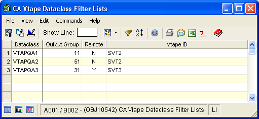

The Dataclass Filter Lists object displays all of the dataclass filters that direct allocations to CA Vtape Virtual Devices. You can display the object to view dataclass filters information. There are no actions for this object.

  2. Click the Dataclass Filter Lists object in the Object Tree.
    The table view of the Dataclass Filter Lists object appears, as shown in the following sample:
    Screen shot example of the Dataclass Filter Lists object.
Note: Click the Help About Object tool bar icon (Screen shot example of the Help About Object Toolbar icon.), to display a description of the field values displayed in the columns in the Dataclass Filter Lists object.
