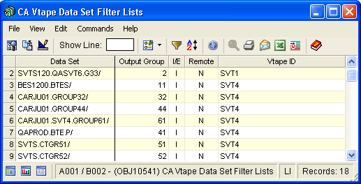

    The table view of the Data Set Filter Lists object appears, as shown in the following sample:
    Screen shot example of the Data Set Filter Lists object.
Note: Click the Help About Object tool bar icon (Screen shot example of the Help About Object Toolbar icon.), to display a description of the field values displayed in the columns in the Data Set Filter Lists object.
