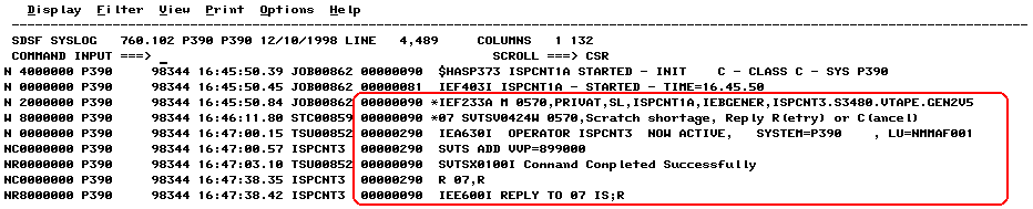

If you do not define enough Virtual Volumes, CA Vtape displays the SDSF SYSLOG Scratch Shortage message, as shown in the following example:
