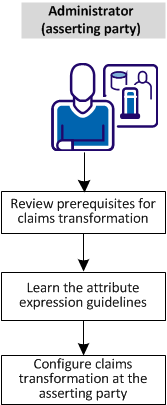

The software can perform three different modifications to assertion attributes:
The following figure shows the configuration steps:
Flow of claims transformatio tasks
To set up claims transformation, perform the following steps:
  1. Review the prerequisites for claims transformation.
  2. Learn the attribute expression guidelines.
  3. Configure claims transformation at the asserting party.

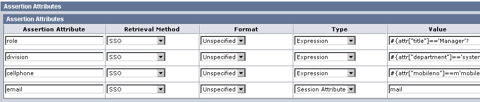

Expressions are rules that instruct the software how to manipulate assertion attributes. The expression directs the software to modify, add, or delete assertion attributes. You construct expressions using the Java Unified Expression Language (JUEL). A JUEL expression evaluator examines the configured expressions and generates the resulting assertion attributes.
Define expressions in the Assertion Attributes table of the Administrative UI. Access this table by navigating to the Assertion Configuration step of the partnership wizard. This table is shown in the following figure:
Graphic showing some examples of attribute expressions
Enter expressions in the Value column of the assertion attributes table. All attributes in an expression are user store or session store attributes.
Typically, the expression operates on a conditional basis. If the condition is met, the designated claims modification occurs. For example, an incoming assertion contains the "role" attribute. The expression to modify the "role" assertion attribute is:
#{attr["title"] == 'manager' ? 'administrator' : attr["title"]}
The first part of the expression #{attr["title"] == 'manager' tells the software to determine whether the logged-in user has the title "manager." The lookup is done in the user directory. If this condition is met, the second part of the expression, ? 'administrator' : assigns the value "administrator" to the role assertion attribute. If the condition is not met, the last part of the expression, attr["title"]} indicates that the value of the user attribute "title" remains "manager." The value "manager" is assigned to the assertion attribute "role."
Note: You can use static values in an expression in place of the syntax attr["title"], such as 'administrator' in the previous example.
The example assumes the "role" attribute is already in the assertion. Therefore, the expression is a transformation of an existing attribute. If "role" is not part of the assertion, the software adds the role attribute to the assertion.

    In the Assertion Attributes section, click Add Row.
  5. Pay particular attention to the following fields in the row. Click Help for detailed descriptions of each field.
    Assertion Attribute
    Enter an assertion attribute. All values in this column are assertion attributes. An attribute that is already in the assertion remains in the assertion, but it is set to a new value based on the configured expression. The attribute is removed from the assertion only if you configure a DELETE expression.
    Retrieval Method
    Keep the default, SSO.
    Format
    Designates the format for the attribute being added to the assertion. The format options vary depending on the SAML profile for the entity.
    Type
    Expression
    Always use this value for claims transformation.
    Value
    Enter an expression that reflects how you want the assertion attribute is modified.
    Review the guidelines about constructing claims expressions and the following examples:
