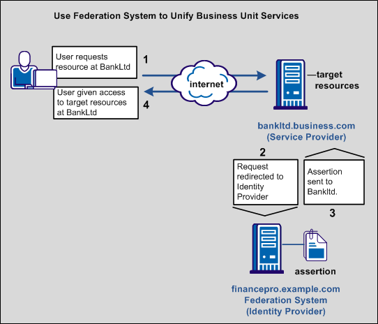

The following graphic shows the federated partnership between Financepro and BankLtd. The flow of communication is based on a SAML 2.0 Service Provider-initiated single sign-on.
Graphic showing the federated partnership between Financepro and BankLtd
The illustration describes the following information flow:
  1. The user tries to access a federated resource at BankLtd.
  2. The user is redirected to the Financepro for authentication and the assertion is generated.
  3. The assertion is passed back to BankLtd.
  4. Single sign-on occurs based on either a SAML HTTP-Artifact or HTTP-POST. The user gets access to the target resource.

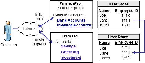

When a customer at FinancePro accesses a resource at BankLtd, the NameID is always in the assertion. This identifier allows BankLtd to determine who the customer is and the level of access to allow for that customer.
The NameID can establish a federated identity when the user store at each partner identifies the users in the same way with the same ID.
The following figure shows the user store at each site with the same employee IDs.
Account Linking with Different User Stores
CA SiteMinder® Federation Standalone lets you configure account linking as part of the partnership configuration process. You specify a NameID format and Name ID type, which determines the type of value that defines the Name. You associate the specific Name ID type, with a static, user, or DN attribute from a user directory. The NameID that CA SiteMinder® Federation Standalone includes in the assertion conforms to the configuration you define.
When the relying party receives the assertion, the user disambiguation process at BankLtd occurs. The process links the NameID value in the assertion to a record in its user store.

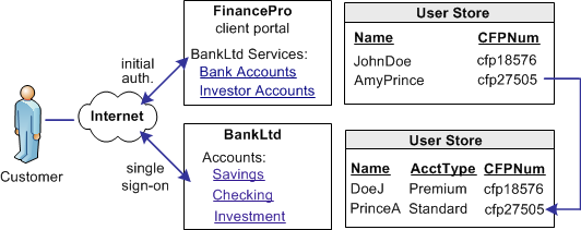

BankLtd maintains user identities for all customers at Financepro, but the identities differ from the identities at FinancePro. For example, at FinancePro, JohnDoe is a customer. At BankLtd, this same customer is identified as DoeJ. Regardless, BankLtd must control access to sensitive portions of the company website. To establish the federated identity, the partners agree on an attribute that maps to the appropriate identity for a single customer at either site.
The partners agree on which attribute to use during an out-of-band exchange of information, meaning that the agreement is not part of any communication in any message over a channel. For this example, the attribute that the partners agree upon is a certified financial planner license number, referred to as the CFPNum in each user store.
When a customer tries accessing the federated resource at BankLtd, the request triggers the single sign-on process. The assertion that is generated at FinancePro contains the CFPNum attribute. When BankLtd receives the assertion, an application at its site has to perform the user disambiguation process. The process relies on the attribute to determine which profile identity is used for the request.
The following illustration shows how the same users are identified differently at each partner.
User Mapping Based on Attribute Profiles
CA SiteMinder® Federation lets you configure identity mapping as part of the partnership configuration process. For the NameID and attribute configuration, you define an attribute called CFPID. Associate this attribute with the user attribute CFPNum, which is the name of the attribute in the user store at each partner.
CA SiteMinder® Federation includes the attribute in the assertion. When BankLtd receives the assertion, the user disambiguation process links the attribute in the assertion to the appropriate record in its user store.

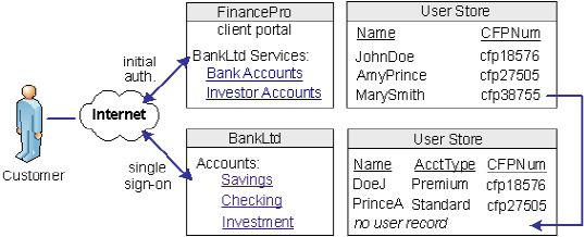

An investor at Financepro, Mary Smith, authenticates and clicks a link to access information at BankLtd. Initially, BankLtd cannot find a user account for Mary Smith. BankLtd wants to protect sensitive portions of its website while allowing new customers.
BankLtd has configured CA SiteMinder® Federation Standalone to implement provisioning to establish the new federated identity for Mary Smith. CA SiteMinder® Federation Standalone redirects Mary Smith to the provisioning server at BankLtd. The provisioning application, using identity information from CA SiteMinder® Federation Standalone, creates a user account in the user store.
The following illustration shows the user stores at FinancePro and BankLtd.
A graphic showing a use case for user provisioning
CA SiteMinder® Federation Standalone lets you configure provisioning as part of the partnership configuration at the relying party. In this example, you select remote provisioning and determine how assertion data is delivered to the BankLtd provisioning server. This configuration enables the dynamic creation of a user entry in the user store.
