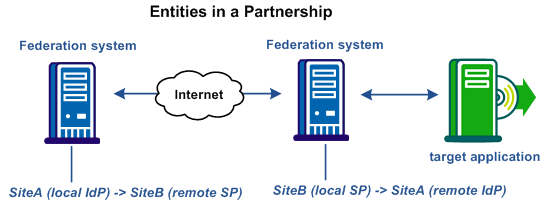

In the following figure, SiteA has been configured as the local SAML 2.0 IdP and has specified SiteB as the remote SAML 2.0 SP. SiteB has been configured as the local SAML 2.0 SP, and SiteA is its remote SAML 2.0 IdP.
The graphic shows federation partnership definitions
