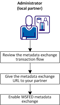

The following graphic shows the configuration steps for metadata exchange.
Configuration steps for WSFED metadata exchange
Complete the following configuration for metadata exchange:
  1. Review the metadata exchange transaction flow.
  2. Give the metadata exchange URL to your partner.
  3. Enable WSFED metadata exchange.
