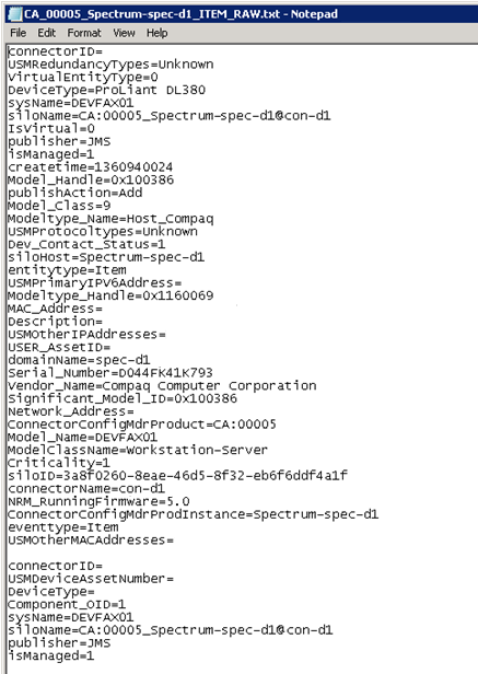

The ITEM_RAW file contains raw details of the newly discovered device in CA Spectrum. The information in this file signifies that the device in CA Spectrum was sent successfully to the CA Spectrum connector.
Therefore, if you see your particular device in this file, it implies that the device has been sent from CA Spectrum to the connector.
Follow these steps:
- Navigate to the SOI_HOME\log\debugData folder on the server where the CA Spectrum connector is installed.
- Open the CA_00005_Spectrum-<SShostname>_ITEM_RAW.txt file.
Note: SShostname specifies the host name of the CA Spectrum server.
- Verify that you see the details of the new device and its child CIs (such as interfaces and ports) in the ITEM_RAW file as shown in the following screenshot:
