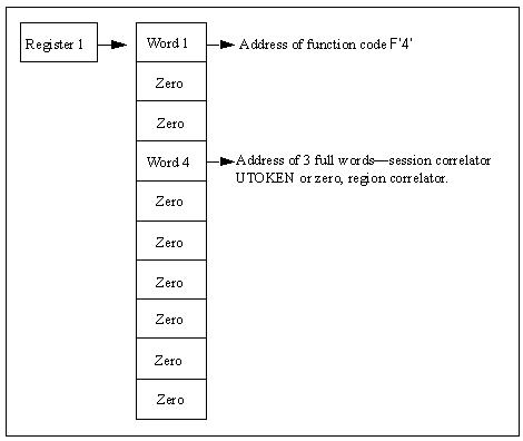

On entry to the security exit, Register 1 points to a list of ten full words, as shown in this diagram.
The diagram shows the parameter list for the System Close Down call.
The contents of the parameter list as follows:
Word 1
Is a fullword containing the address of function code F‘4’.
Words 2 and 3
Are set to zeros.
Word 4
Is the address of three full words, each containing the information that was passed on the system initialization call.
Words 5 through 10
Are set to zeros.
