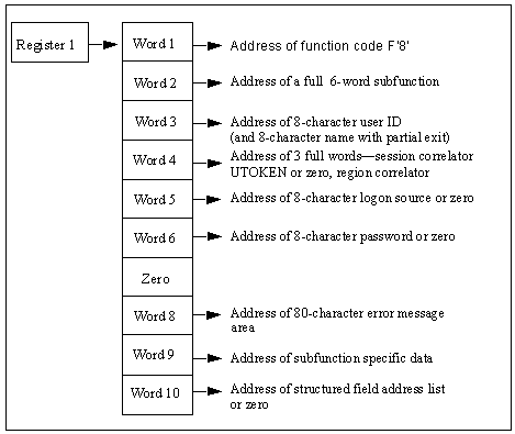

On entry to the security exit, Register 1 points to a list of ten full words, as shown in this diagram.
The diagram shows the parameter list for the User Logon Request call.
The contents of the parameter list are as follows:
Word 1
Is a fullword containing the address of function code F‘8’.
Word 2

Word 3
Is the address of an eight-character field, blank padded, containing the user ID requesting the logon. If a partial security exit is installed then there is an additional, contiguous eight-character field, blank-padded containing the model user ID specified by the SYSPARMS MODLUSER operand. If no model user has been specified this field is set to blanks.
Word 4
Is the address of two full words:
These values are returned in all subsequent calls to the exit in reference to this user ID session, so that it can be used as a session correlator.
Word 5
Varies according to subfunction code.

Word 7
Is set to zero.
Word 8
Is the address of an 82-character area into which the exit can place any error message text if the logon request is denied. Any text placed in this area is displayed to the user in response to the logon attempt. If an error message is returned in this area it must be formatted as follows:

Word 9

Word 10
Depends on whether you have a full or partial security system:
If the requesting user ID is not defined on UAMS, Word 10 is zero.
