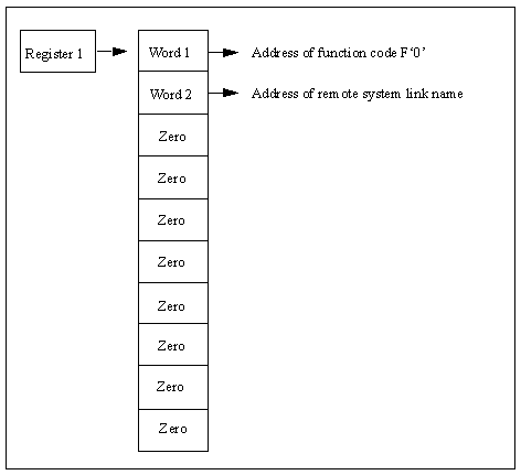

Initialization Call Parameter List
On entry to the secondary exit, Register 1 points to a list of ten full words, as shown in this diagram.
The diagram shows the parameter list for the Initialization call to an INMC secondary exit.
Word 1
Points to a full word containing function code X‘00000000’. Other words in the parameter list point to additional parameters.
Word 2
Is the address of the link name of the remote system with which a link has been established. There may or may not be a primary exit defined for that system. If there is, it is up to the primary exit to determine whether it wants to communicate with this secondary exit.
Words 3 to 10
Are set to zero.
Return Codes from the Initialize Call
The secondary exit does not have an opportunity to respond to the initialize call. On completion of any processing it chooses to perform when passed control, the secondary exit should return to your region with its ten full word parameter list unchanged.

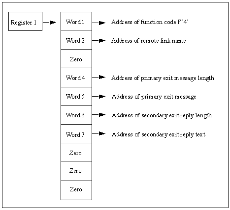

Deliver Call Parameter List
The diagram shows the parameter list for the Delivery call to an INMC secondary exit.
Word 1
Points to a full word containing function code X‘00000004’.
Word 2
Is the address of the link name of the remote system from which the message has been received.
Word 3
Is set to zero.
Word 4
Is the address of a full word containing the length of a message sent from the primary exit in the remote system. The maximum length is 256 bytes (decimal), minimum is zero (which would be a null message).
Word 5
Is the address of the message sent from the primary exit.
Word 6
Is the address of a full word, value F‘0’. The secondary exit can place in this field the length of a message that is to be sent to the primary exit in the remote system. The maximum length is 256 bytes (decimal). If a longer length is specified it is truncated to 256. If a negative length is specified it is forced to 256.
Word 7
Is the address of an area in which the secondary exit can place the text of a message that is to be sent to the primary exit in the remote system. The message is assumed to be left aligned in this message area. The maximum message text length is 256 bytes (decimal). The data in the message can be binary or character and is transparent to your region.
The meaning and format of the message sent to the primary exit is determined by the installation.
Words 8 to 10
Are set to zero.
Return Codes from Secondary Exit Deliver Call
The secondary exit should set the full word pointed to by word 6 of the call parameter list to the length of the message text that is to be returned to the primary exit as a reply to the message just delivered.
The message length has a range of 0 to 256 in hexadecimal. Any text outside the specified range is truncated to 256 bytes decimal. A zero length is accepted. Negative length settings are forced to a zero value.
Word 7 of the call parameter list points to a 256-byte area in which the secondary exit can place the text of the message to be returned to the primary exit. The format and content of the message returned is decided by the installation.
No other return information is accepted from the secondary exit.

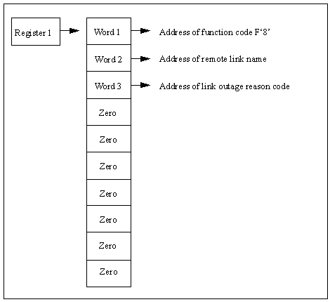

Disconnect Call Parameter List
The diagram shows the parameter list for the Disconnect call to an INMC secondary exit.
Word 1
Points to a full word containing function code X‘00000008’.
Word 2
Word 3
The address of 1 byte disconnect reason code. Valid values are:
Field Value
Definition
X‘00’
Orderly termination of communication by choice of the primary exit.
X‘04’
Disconnection caused by loss of contact.
Words 4 to 10
Are set to zero.
Return Codes from the Disconnect Call
The secondary exit should clean up any resources allocated during the conversation with the primary exit and perform any required termination processing. No further communication is possible with the primary exit.
No parameters can be returned to your region.
On return to management service, the link either is out of action (if caused by a link outage) or is activated or deactivated according to the choice of the primary exit in the remote system.
