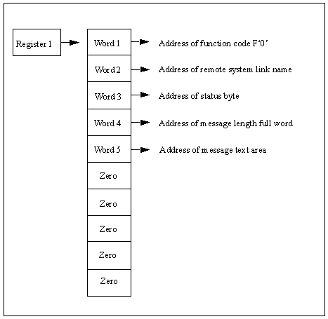

Initialization Call Parameter List
On entry to the Primary exit, Register 1 points to a list of ten full words, as shown in this diagram.
The diagram shows the parameter list for the Initialization call to an INMC primary exit.
Word 1
Points to a full word containing function code X‘00000000’. Other words in the parameter list point to additional parameters.
Word 2
Is the address of the 1 to 12 character link name of the remote system with which a link has been established.
Word 3
Is the address of a 1-byte field that specifies the status of the secondary exit in the remote system. Values of this field and the meanings are as follows:
Field Value
Definition
X‘00’
A secondary exit is available for communications.
X‘04’
The remote system does not have a secondary exit defined. No SYSPARMS INMCEX02 command has been issued in the remote system.
X‘08’
The remote system has a secondary exit defined but the load module (or phase) was not loaded successfully.
Word 4
Is the address of a full word, value F‘0’. The primary exit can place in this field the length of a message that is to be sent to the secondary exit in the remote system. The maximum length is 256 bytes (decimal). If a longer length is specified it is truncated to 256. If a negative length is specified it is forced to 256.
Word 5
Is the address of an area in which the primary exit can place the text of a message that is to be sent to the secondary exit in the remote system. The message is assumed to be left aligned in this message area. The maximum message text length is 256 (decimal) bytes. The data in the message can be binary or character and is transparent to your region. The meaning and format of the message sent to the secondary exit is determined by the installation.
Words 6 to 10
Are set to zero.

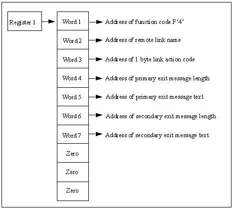

Delivery Call Parameter List
On entry to the primary exit, Register 1 points to a list of ten full words, as shown in this diagram.
The diagram shows the parameter list for the Delivery call to an INMC primary exit.
Word 1
Points to a full word containing function code X‘00000004’.
Word 2
Is the address of the link name of the remote system with which a link has been established.
Word 3
Is the address of a full word in which the primary exit can return a code indicating whether the link is to be opened for normal INMC traffic.
Word 4
Word 5
Is the address of an area in which the primary exit can place the text of a message that is to be sent to the secondary exit in the remote system. The message is assumed to be left aligned in this message area. The maximum message text length is 256 bytes (decimal). The data in the message can be binary or character and is transparent to your region. The meaning and format of the message sent to the secondary exit is determined by the installation.
Word 6
Is the address of a full word containing the length of a message sent from the secondary exit in the remote system. The maximum length is 256 bytes (decimal), minimum is zero (which would be a null message).
Word 7
Is the address of the message sent from the secondary exit.
Words 8 to 10
Are set to zero.
Return Codes from Delivery Call
When the primary exit completes its processing of the message returned from the secondary exit it formats the ten word parameter list to indicate the processing required next and then returns to your region.
The parameter list must be set exactly.

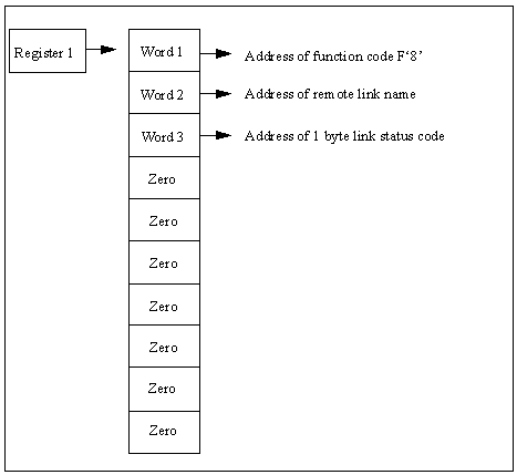

Notify Call Parameter List
The diagram shows the parameter list for the Notify call to an INMC primary exit.
Word 1
Points to a full word containing function code X‘00000008’.
Word 2
Is the address of the link name of the remote system with which contact has been lost.
Word 3
Is the address of 1-byte field containing a notify code. Valid values are as follows:
Field Value
Definition
X‘04’
X‘08’
X‘0C’
The link has been lost.
Words 4 to 10
Are set to zero.
Return Codes from Notify Call
When the primary exit completes its processing of the notify call it should format the ten word parameter list as follows:
Word 1
Is the address of a function code specifying the action that the exit requires your region to take. The values of this function code must be F’4’ (Exit processing is to terminate).
The remaining nine full words should be returned unchanged.
