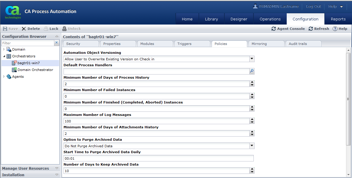

In this release, the following field is changed at the Configuration Browser level and the Object level.
Minimum Number of Finished (Completed, Aborted) Instances
Defines the minimum number of Finished (completed and aborted) instances of each object for every object type (process, schedule, and SRF) that are retained. To view the retained instances of an object, select the Current filter of the respective object from the Operations dashboard.
The remaining objects are archived and to view the archived objects, select the Archived filter of the respective object from the Operations dashboard.
When the Finished (completed and aborted) instances exceed the specified value, the application archives the instances of each object for every object type. The instances are archived with the oldest timestamp of completion.
However, the instances are archived only after they are retained for a minimum number of days as specified in the Minimum Days of Process History field.
For example:
If there are 3 objects (Process,Schedule, SRF) and assume each object has 3 object instances, then there are 9 object instances for the 3 objects. If you specify 1, then 1 object instance for each object type is retained and the remaining is archived.
Default: This input field defaults to 0. You can specify a positive integer value.
When 0 is specified, instances are archived but are not retained.

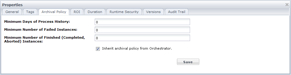

Configuration Browser Level Changes
ConfigurationBrowserInstances
Defines the minimum number of Finished (completed and aborted) instances of the Object (Process, Schedule, and SRF) that are retained. To view the retained instances of an object, select the Current filter of the respective object from the Operations dashboard.
The remaining objects are archived and to view the archived objects, select the Archived filter of the respective object from the Operations dashboard. When the number of Finished (completed and aborted) instances exceed the specified value, the application archives the object instances with the oldest timestamp of completion.
Default value: 0. You can specify a positive integer value.
Object Level Changes
ObjectInstances
