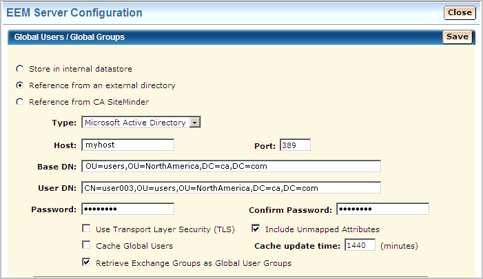

While you are installing CA EEM r8.4, you can select the Reference from an External Directory option and then select Microsoft Active Directory as the type.
When you use NTLM for security, select the Retrieve Exchange Groups as Global User Groups check box as in the following example:
When you save the configuration, the following status messages appear:
