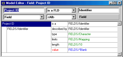

When you drag one or more objects to the body of the Model Editor, the display changes to show you only the triples that define those objects. This is called focusing the Model Editor. When you drag the Project ID field to the Model Editor, it focuses on this field, showing the triple Project ID is a FIELDS/Identifier. This still does not give you much information.
The Model Editor shows another level of detail.
Now you can see that Project ID has inherited a data type of character and length of 10, along with the value *Blank (which you saw in the Object Browser in Step 7).

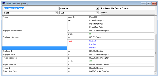

All of the triples appear in the model again.
Note: If your Model Editor displays many more triples than shown in the previous graphic, then you have your model set to display library objects. If this is the case, click the Show/Hide Library Objects toolbar button.
The Model Editor displays the triple as:
Project Description is a FIELDS/ShortDescription
This indicates that you correctly spelled the name of the pattern library field.
Note: If you create a new object for a model, and it happens to share the name of a library object, you must rename your object or delete it (if you did not intend to create it).
Project Start Date is a DATE/CheckedDateISO
Project End Date is a DATE/CheckedDateISO
Project Description Length NBR 255
Your Model Editor should look like this:
Inheriting from DATE/CheckedDateISO gives the fields functionality to ensure that end users enter valid dates.
