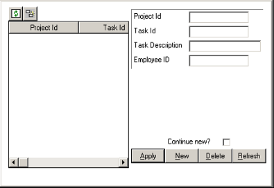

  1. Open Project.Maintain Projects.Panel. You may need to refresh the Object Browser to display the panel.
    It currently looks like this:
    Because you made it a child panel, you have no title bar or dialog frame. You can see the panel elements that it inherited from Task.Edit.Panel, but you cannot yet see the elements inherited from Grid2.Panel.

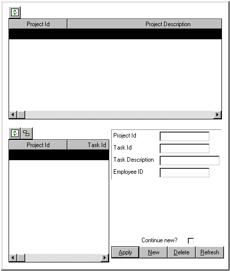

  2. In the Design Window, drag the bottom edge of the dialog to make it about twice as tall.
  3. In the Panel Palette, select DetailP, GridP, GridButtonP, DetailButtonP, and Panel:
  4. In the Design Window, drag the selected elements to the bottom of the panel.
    Note: There is a second grid region—it was behind the one you just moved down. Your panel should look like this.
