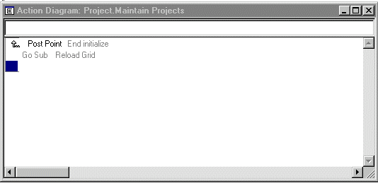

  4. Double-click the Post Point below the End Initialize Edit Point.
    This is the first Post Point that already has content:
    Adding Action Diagram Code
    You can only add code at the end of a Pre or Post Point, below any statements that are already there.
  5. Click just below the Go Sub Reload Grid line, and enter the following statement:
    Go Sub Reload Grid2
    This statement loads the project grid when the panel is initialized.

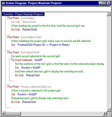

  17. To check that you entered all the required code, choose Show Local Modifications from the View menu. Use the space bar to expand each construct.
    Your action diagram should look like the following example. This example includes extra comments in the code:
    PLEX--Adding Action Diagram Code (2)
  18. Reset the action diagram display by choosing Show Full Logic from the View menu.
