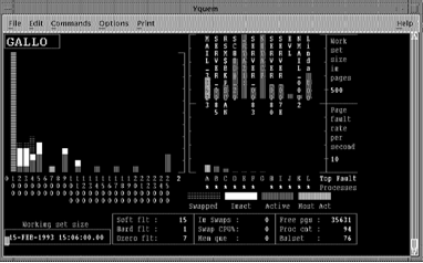

If an examination of the system overview reveals a memory limitation, you can investigate the cause of the limitation in more detail using the Memory display. The following illustration is an example of the Memory display:
The Memory display draws attention to the following indicators:
