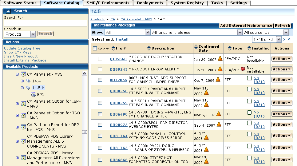

Maintenance information appears at the right for the releases you have.
The maintenance information is updated.
The maintenance packages are listed, for example:
Red asterisks identify HIPER maintenance packages.
The Maintenance Package Details dialog appears, identifying any prerequisites.
Note: The Installed column indicates whether a package is installed.
