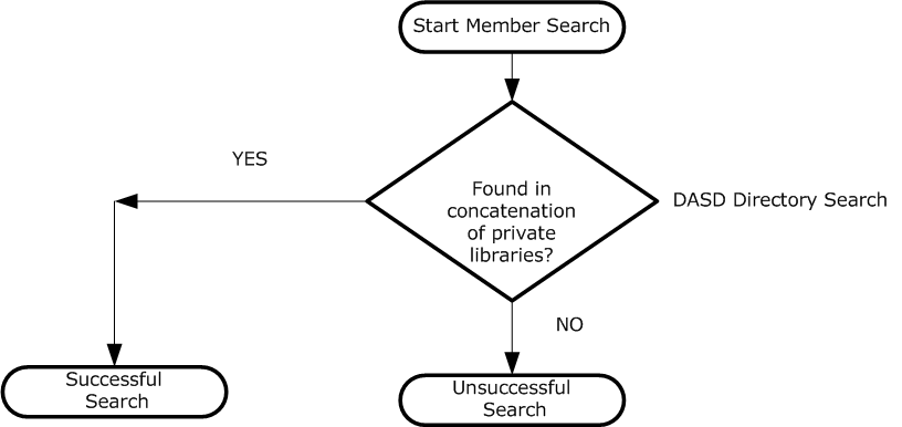

  1. Search of Private Libraries only: The program issues a BLDL/FIND request. This request usually initiates a DASD I/O search of the directories of the private libraries in the concatenation specified in the JCL, as the following illustration shows. (The request may result in an in-storage search if LLA manages the libraries to be searched.)
    pmoutpm1
    Private Libraries-Only Search

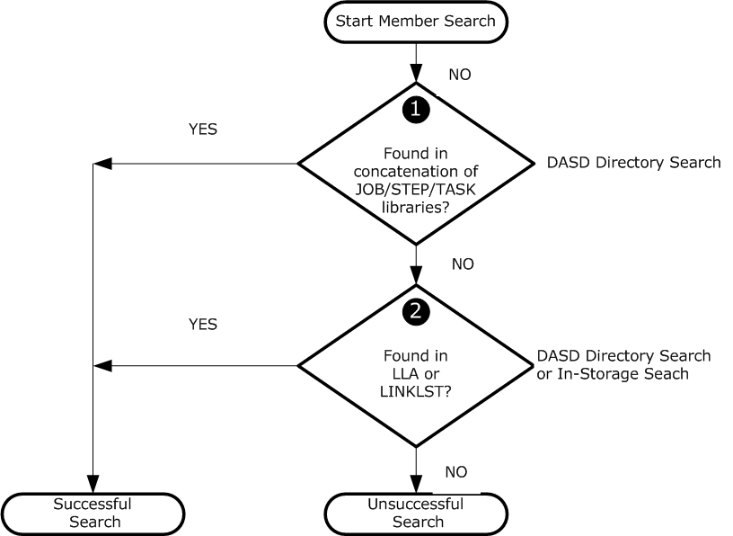

  2. Search of Private and LNKLST Libraries: The program issues a BLDL request to initiate a directory search against a concatenation of JOB/STEP/TASK libraries allocated for the program. (The FIND macro cannot initiate this type of directory search.) The search is usually conducted on DASD. (There may be an in-storage search if LLA manages the libraries involved in the search.) If the load module is not found, z/OS attempts to find it in the LLA address space or the LNKLST libraries (see the following illustration).
    This search also may be conducted on DASD.
    pmoutpm2
Private and LNKLST Libraries Search
Note: Programs seldom use this procedure to initiate a search for a nonload module. One possible exception is when you invoke a CLIST member from TSO. If you omit a percent sign (%) preceding the CLIST member name, the JOB/STEP/TASK libraries and the LNKLST libraries are searched unnecessarily.
