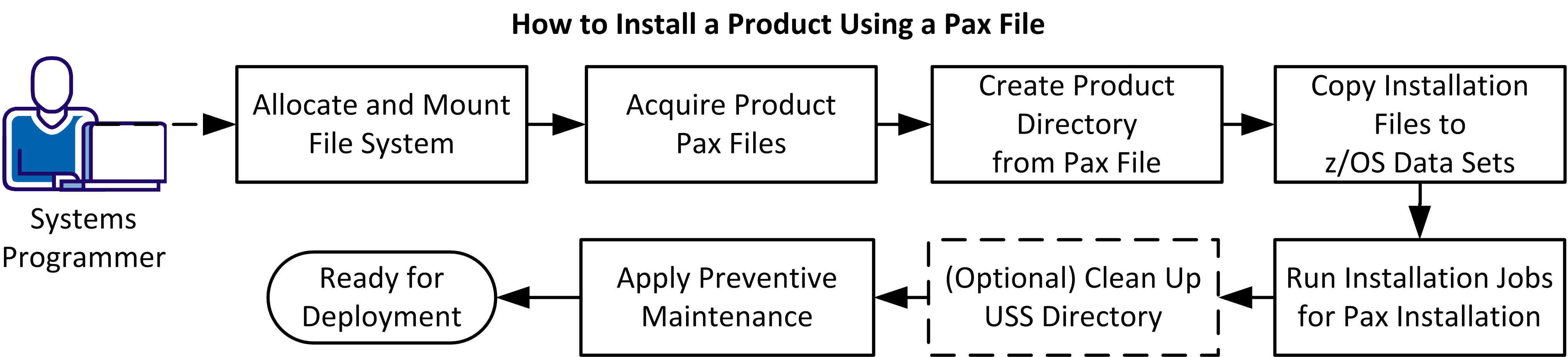

You perform the following tasks to install a product with a pax file:
The flowchart shows the process of installing WebCenter.
  1. Allocate and mount the file system.
  2. Acquire the product pax files.
  3. Create a product directory from the pax file.
  4. Copy the installation files to z/OS data sets.
  5. Run the installation jobs for a pax installation.
  6. (Optional) Clean up the USS directory.
  7. Apply preventive maintenance.
