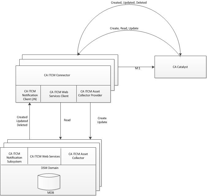

With CA Catalyst connector integration, there is one CA ITCM connector per domain. The CA ITCM connector interfaces with the domain manager using the following CA ITCM components or functionality:
CA ITCM Web Services is used to retrieve information about the CIs to be published to CA Catalyst connector.
Events about updates to published CIs are received through the CA ITCM event notification subsystem.
The Asset Collector component is used during CA Spectrum SA subscribe operations for Computer CI data. The Asset Collector files help to move the inbound create data and update data from the connector to the CA ITCM MDB.
The following graphic summarizes CA ITCM - CA Catalyst connector integration:
