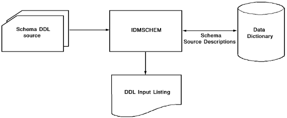

To compile the schema created by the transparency generator, execute the program IDMSCHEM.
Schema Compiler Execution
The following figure shows the execution of the schema compiler.
Input to IDMSCHEM
The input to IDMSCHEM is the source schema DDL output by the generator.
