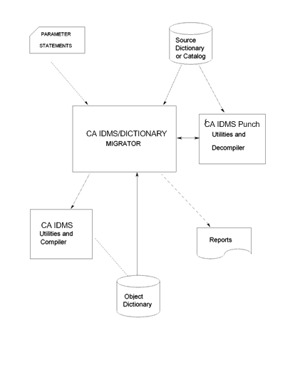

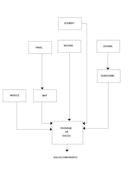

Migrating a system requires extracting its components from source dictionaries and transferring them to an object dictionary. CA IDMS Dictionary Migrator performs the processing automatically. The second graphic illustrates CA IDMS Dictionary Migrator processes.
You can direct and control this process easily with CA IDMS Dictionary Migrator's parameters. Parameters give you the flexibility to perform simple or complex migration.
For a simple migration you need to specify the source and object dictionaries and the system that is going to be migrated. For a more complex migration, select from many optional parameters that set up criteria and tailor the process to meet your needs.
This graphic shows the dialog components.

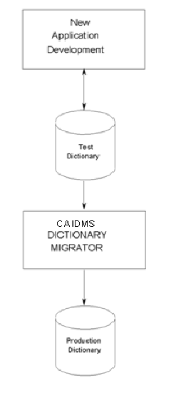

New Applications Environment
You can use CA IDMS Dictionary Migrator to copy a new application into production. The following graphic illustrates how easily this can be done.
Before the actual transfer to a production environment you can direct CA IDMS Dictionary Migrator to produce reports. From the reports you can review system components and relationships as they exist in the source dictionary and the syntax statements that CA IDMS Dictionary Migrator will provide for the actual migration.
When you have completed your review, you need only run the upload step of the migration you are performing. CA IDMS Dictionary Migrator generates all the syntax necessary for the migration.
This graphic shows a new application development flowchart

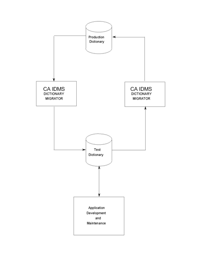

Existing Applications Environment
CA IDMS Dictionary Migrator is as useful in an existing applications environment as it is in the new applications environment. CA IDMS Dictionary Migrator allows you to perform testing and maintenance on a system without disturbing its production environment. The following graphic illustrates how you can use CA IDMS Dictionary Migrator for existing applications maintenance.
CA IDMS Dictionary Migrator produces a comprehensive listing of the production system and its components. From the listing you can select the necessary components--source and load modules that store dialogs, messages, tables, schemas, subschemas, maps, and panels, that are moved to the test dictionary.
The components can be assigned to a new version number to keep them distinct from current production entities. This makes it easy to test changes in entity definitions and make system modifications while keeping the production system intact.
When testing is complete, you can examine the reports to compare the system in maintenance to the original production system. Once you've noted the changes, you can migrate the changed portions back to the production version.
By selecting only the modified components, you can significantly reduce the time it takes to copy tested applications back into the production environment. CA IDMS Dictionary Migrator moves the modified system from its test dictionary to the production dictionary accurately and quickly.
This graphic shows a flowchart of existing applications.

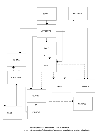

Migrate by Organizational Structure
Migrating a system by its organizational structure is especially useful when you have linked all programs to an attribute, a system, a user, a program, or a dialog.
For example, if every dialog of your billing system is linked to the system structure named BILLING, you need only identify how it is organized for a migration. By specifying SYSTEM=BILLING, you can direct CA IDMS Dictionary Migrator to locate every program or dialog associated with the system. CA IDMS Dictionary Migrator will follow dictionary relationships to locate every component used by the billing system's programs or dialogs.
This method provides an efficient way to trace systems that are very large or that have been in development for a long time. For more information see the following flowchart.
This flowchart shows migration using organizational structure

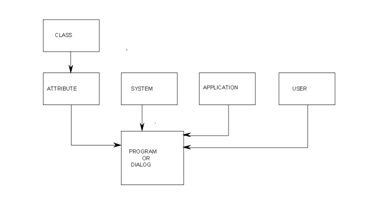

Migrate by Organizational Structure Without Regard to Dialog
Migrating a system by its organizational structure is especially useful when you have linked an entire system to an attribute.
For example, if every component of your billing system is linked to the ATTRIBUTE structure named BILLING, you need only identify how it is organized for a migration. By specifying ATTRIBUTE=BILLING, and LEVEL=ENTITY, you can direct CA IDMS Dictionary Migrator to locate every entity occurrence associated with the system. CA IDMS Dictionary Migrator follows dictionary relationships to locate every component used by those entity occurrences. For more information see the following flowchart.
This graphic shows organizational structure without regard to program/dialog relationship

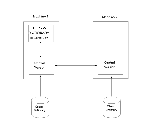

Single Job Execution--Using Node Communication
If you have node communication support, you can easily perform a migration in a multiple machine environment with a single-job execution of CA IDMS Dictionary Migrator. You enter parameters that allow you to identify the source and object central version nodes and the source and object dictionary.
The following graphic illustrates the single execution process.
This graphic shows single job execution in a multiple machine environment

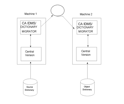

Two-Job Execution
If you do not have node communication support, you can easily process the migration in two jobs.
During the first job, the requested information from the source dictionary CPU is exported and stored on tape.
During the second job, the tape is read and source dictionary information is imported to another CPU and loaded in the object dictionary. Verification, discrepancy and cross-reference reports are also produced in this job. The following graphic illustrates the two-job process.
This graphic shows two job execution in a multiple machine environment
