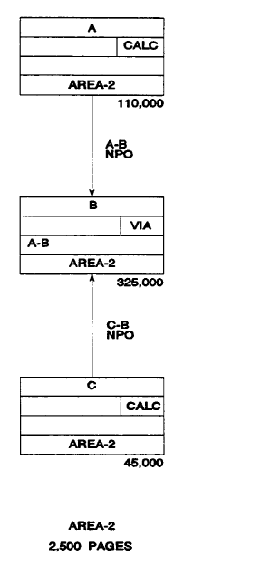

For example, in Figure 5.3, auditing for set disconnections in AREA-2 would take approximately:
    2,500 pages swept
+ 975,000 I/Os for set C-B (325,000 * 3)
 = 977,500 I/Os
Disconnect processing is independent of CALCSETS and USERSETS auditing. The number of I/Os generated by disconnect processing is in addition to the number of I/Os generated by CALCSETS and USERSETS auditing (except for the number of I/Os generated by area sweeping).
Figure 5.3: AREA-2, Estimating DISCONNECT I/Os
