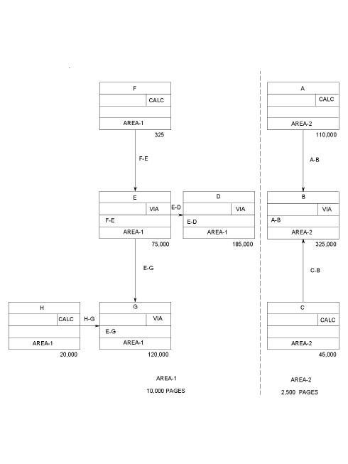

Figure 5.2 provides an example. If you are auditing USERSETS within AREA-1 with WALKNEXT (set H-G is the only non-VIA set), you would estimate the number of I/Os as follows:
(l = 120,000/20,000 = 6)
   10,000 pages swept
 + 720,000 I/Os for set H-G (20,000 owner records * 36)
 = 730,000 I/Os

Figure 5.2: AREA-1 and AREA-2, Estimating WALKNEXT I/Os
