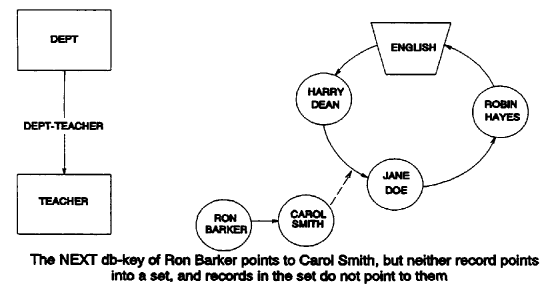

CA IDMS/DB Audit found a record that can not be retrieved when the set is walked from the owner, even though the record points into the set.
For example, in Figure 2.28, records Carol Smith and Ron Barker are connected into the set occurrence owned by the ENGLISH record. When the set is walked from the owner record (ENGLISH), however, only Harry Dean, Jane Doe, and Robin Hayes are retrieved. The Carol Smith and Ron Barker records can only be retrieved if stored CALC, or if the area is swept. CA IDMS/DB Audit corrects this situation by making Harry Dean point to Ron Barker.

CA IDMS/DB Audit could not retrieve an owner record in a set occurrence that was entered either by retrieving one of the member records in an area sweep or by retrieving a member record that was stored CALC. In addition, the member record chain cannot be retrieved by walking from the owner of the set.
For example, in Figure 2.29, TEACHER records Ron Barker and Carol Smith are connected together; however, no valid owner of a DEPT-TEACHER set points to the string. Also, Carol Smith's next db-key is invalid. CA IDMS/DB Audit cannot correct this situation.
