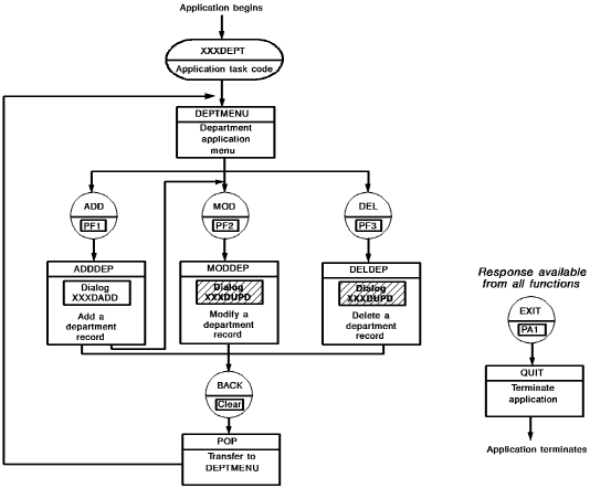

The final structure of the sample Department application is shown below. Dialog XXXDUPD is the only component in the application that requires further development. In this chapter, you will enhance dialog XXXDUPD by writing three process modules for the dialog. When you complete dialog XXXDUPD, you will have finished defining the sample Department application. Dialog XXXDUPD, which is executed by functions MODDEP and DELDEP, is the only component in the sample application that requires further development.
As the diagram indicates, dialog XXXDUPD is executed by both functions MODDEP and DELDEP. Therefore, process modules that you write for dialog XXXDUPD must be able to both modify and delete department information in the database.
