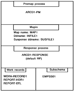

Dialog ARCD1 executes at the beginning of the application. ARCD1 reads an input file that contains a list of ids of employee records to be archived. ARCD1 serves as a mainline dialog, passing control to other dialogs, as required, to archive the employee and associated coverage records and to write report lines to a report file. ARCD1 also writes erroneous input records to a suspense file.
The dialog definition for ARCD1 is illustrated below:
The premap process, mapin operation, and response process are shown below.
