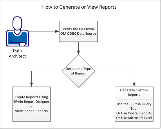

The following diagram illustrates how you can generate reports on model metadata:
Use the following tasks to generate reports on model metadata:
