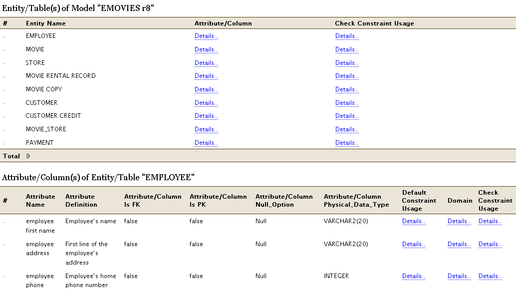

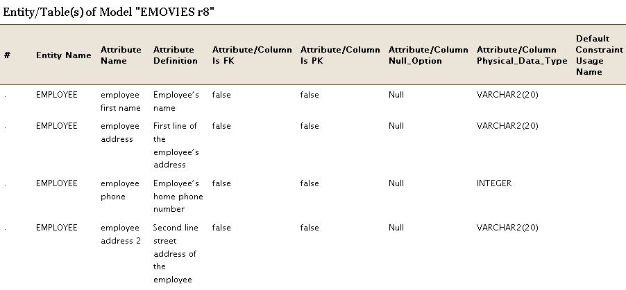

      Roll up subtables: Specifies that you want to display a parent and its child node details together. This option is not effective when the report has only one node. The following image illustrates a report without selecting the Roll up subtables option:
    Report without selecting the Inline option
    The following image illusrates a report when the Roll up subtables option is selected:
    Report when the Inline option is selected
