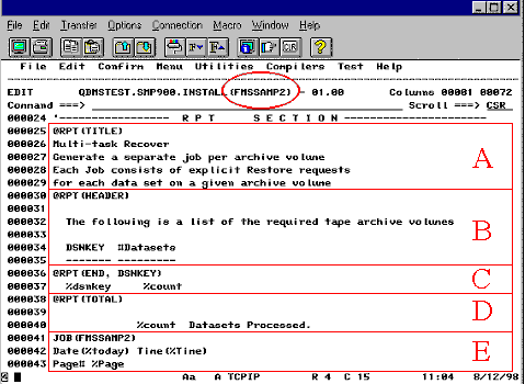

This template, once customized to conform to site standards, can submit a separate RESTORE job for each ARCHVOL tape volume. It also demonstrates the process you need to follow in order to generate a report showing which tape volumes will be needed.
Since the multiple RESTORE job section of this template was covered using FMSSAMP1 in Creating Multiple RESTORE Jobs, the focus of this discussion will be on generating the report.
The following illustration is a Sample INSTALL Member – FMSSAMP2 which is the second half of the template, the RPT SECTION.
