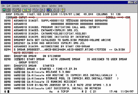

There is a diagnostic feature in this interface that can help you solve problems related to Auto-Restore. To activate this feature, simply assign a job name value to sysparm ARDIAGNM. Setting this sysparm instructs the Test Auto-Restore Interface to issue diagnostic messages to each job that enters the system with this job name.
The following illustration shows some of the typical messages routed to SYSLOG when the ARDIAGNM sysparm is activated:
Note: For detailed information, see the sysparm description ARDIAGNM_jobname in the Systems Guide.
