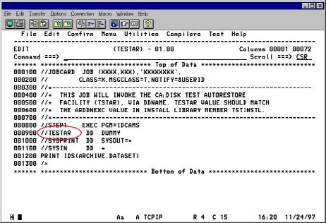

For example, with sysparm ARDDNEXC set to a value of TESTAR, the Test Auto-Restore Hook Interface is invoked for all jobs displaying the TESTAR DD statement as shown in the following illustration:
