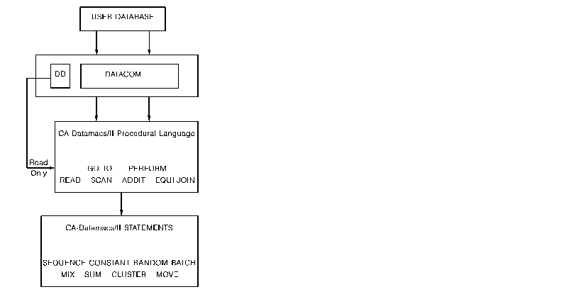

To CA-DATACOM/DB, CA-Datamacs/II looks like a conventional user that reads from the Datadictionary, and requests database access. It constructs a dynamic User Requirement Table during processing.
The diagram below illustrates this interrelation.
PICTURE 1
The CA-Datamacs/II CA-DATACOM/DB procedural language is syntactically similar to, and parallels the scope of, the DATACOM Data Manipulation Language, DML. The CA-Datamacs/II CA-DATACOM/DB procedural language will be discussed in detail later in this documentation.
